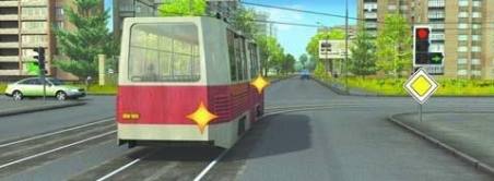

In this situation the road must be given way by
The tram driver.
The light on the right has lit the red lens, and in the additional section the green right-turn arrow is lit. The red-and-white tram is standing on the rails ahead of you with its right indicator flashing; that is, it wants to turn in the direction of that arrow. On the left of the picture, a passenger car is passing along the crossing road, because the light for that direction is green.
The rule: when moving in the direction of an additional-section arrow lit simultaneously with a red or amber light, the driver — and equally the tram driver — must give way to vehicles coming from other directions. The rail vehicle's usual advantage does not hold in this state and is set aside.
The second point in the picture matters too: the yellow diamond "priority road" sign is fitted beneath the light, but as long as the traffic light is working the priority signs are not applied. So you cannot invoke that yellow diamond to treat yourself or the tram as taking precedence.
Safety reason: at a junction where one direction has a full green, vehicles enter at normal speed without expecting an obstacle. If a heavy tram comes forward under the green arrow relying on its "rail advantage", a collision with the green flow is effectively unavoidable, because the tram can neither deviate nor stop quickly.
Exam trap: the memorised sentence "the tram always takes precedence".
• This option extends the rail vehicle's general advantage to all cases, but the passenger car comes from a direction whose light is green and the tram is moving on an arrow accompanied by red; in that combination the tram is the giver of way, not the receiver.
