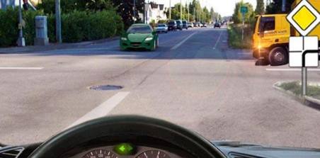

What vehicle must you give way to if you intend to make a U-turn at an intersection?
Only the truck. The yellow diamond on the right tells you that you are on the major road, and the plate beneath shows that the major road arrives from your side and turns right at the intersection — so the right-hand branch is the continuation of the major road and the road coming from the left is minor. The yellow truck is approaching on that right-hand branch, and a U-turn drags your car across the full width of the carriageway, cutting in front of it, so you must yield. The green car on the left is on the minor road and waits for you. On a major-road-direction plate the thick line is the major route and the thin lines are minor — that small plate decides everything.
